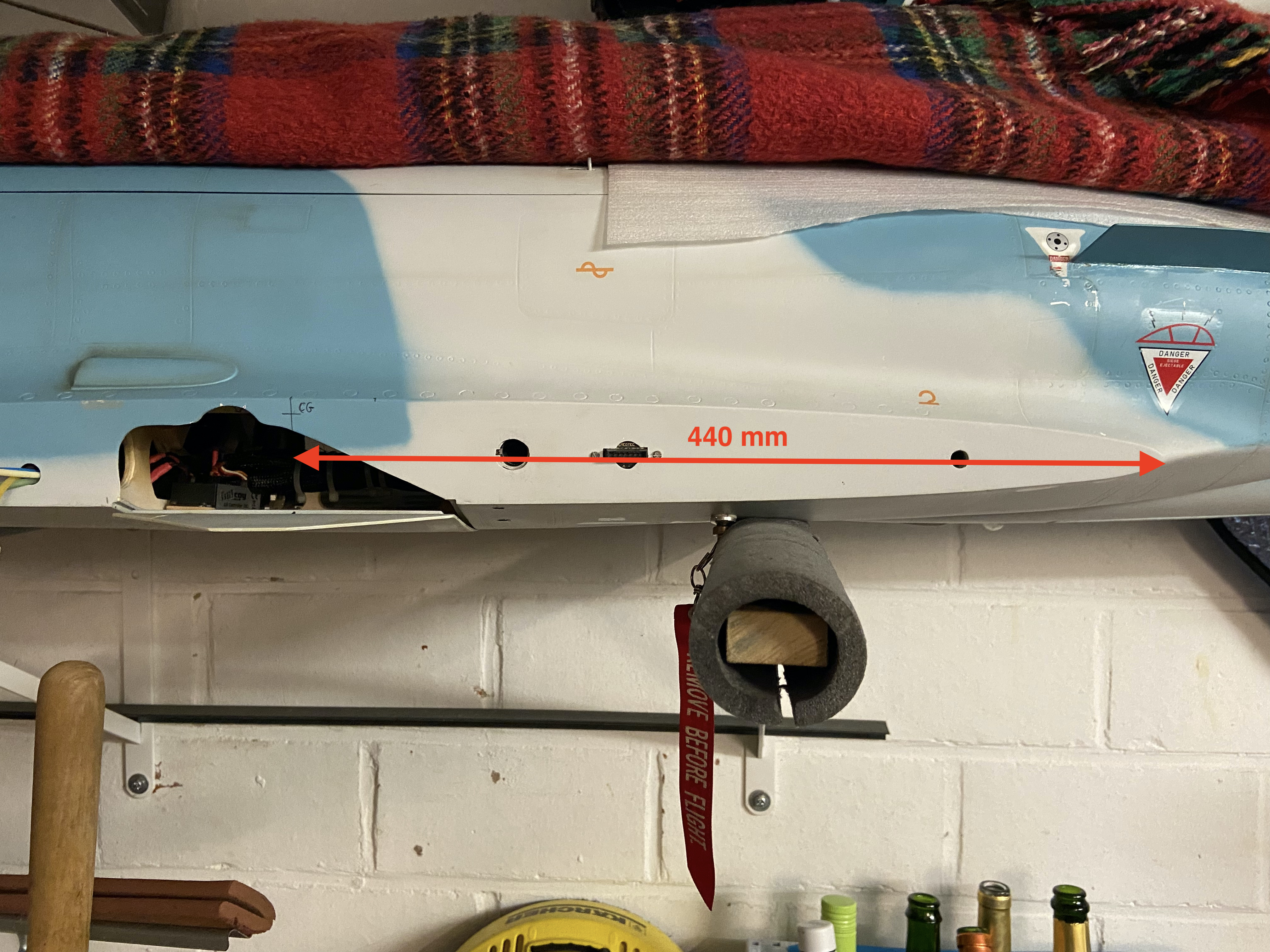

Rafale_Sport a écrit : mer. sept. 02, 2015 9:30 pm poids et CG à vide (UAT pleine, cockpit avec 2 pilotes et batteries en place)
Hello!!!
I would like to know which was the place you used as a reference to level the mirage and use the xicoy balance meter.
Thanks a lot!
Rafale_Sport
Messages : 390
Re: [Construction] Mirage 2000 Feibao
Message par Rafale_Sport »
Hi, not sure about your question, but there are screenshots of the CG meter on page 26, the CG is at 440mm from the leading edge on the fuselage (see picture)
. Hope that helps.
