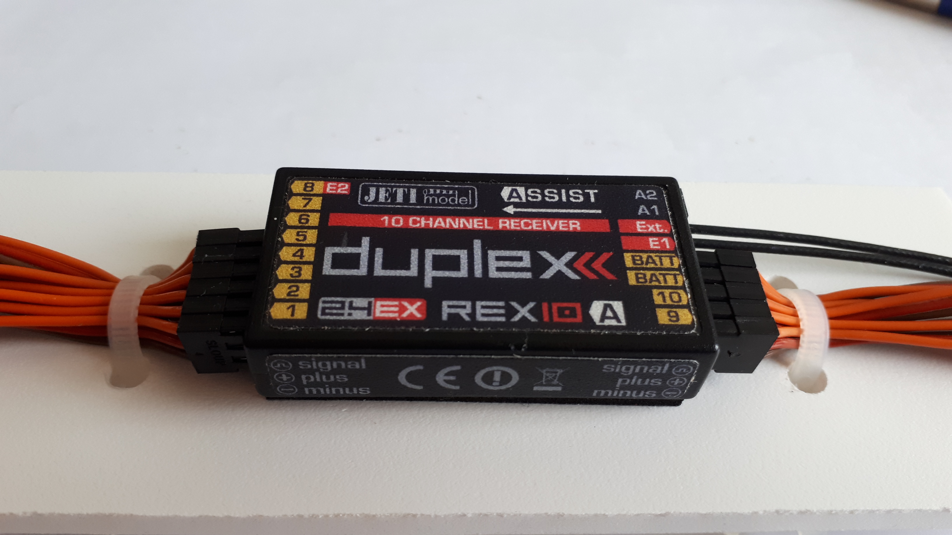

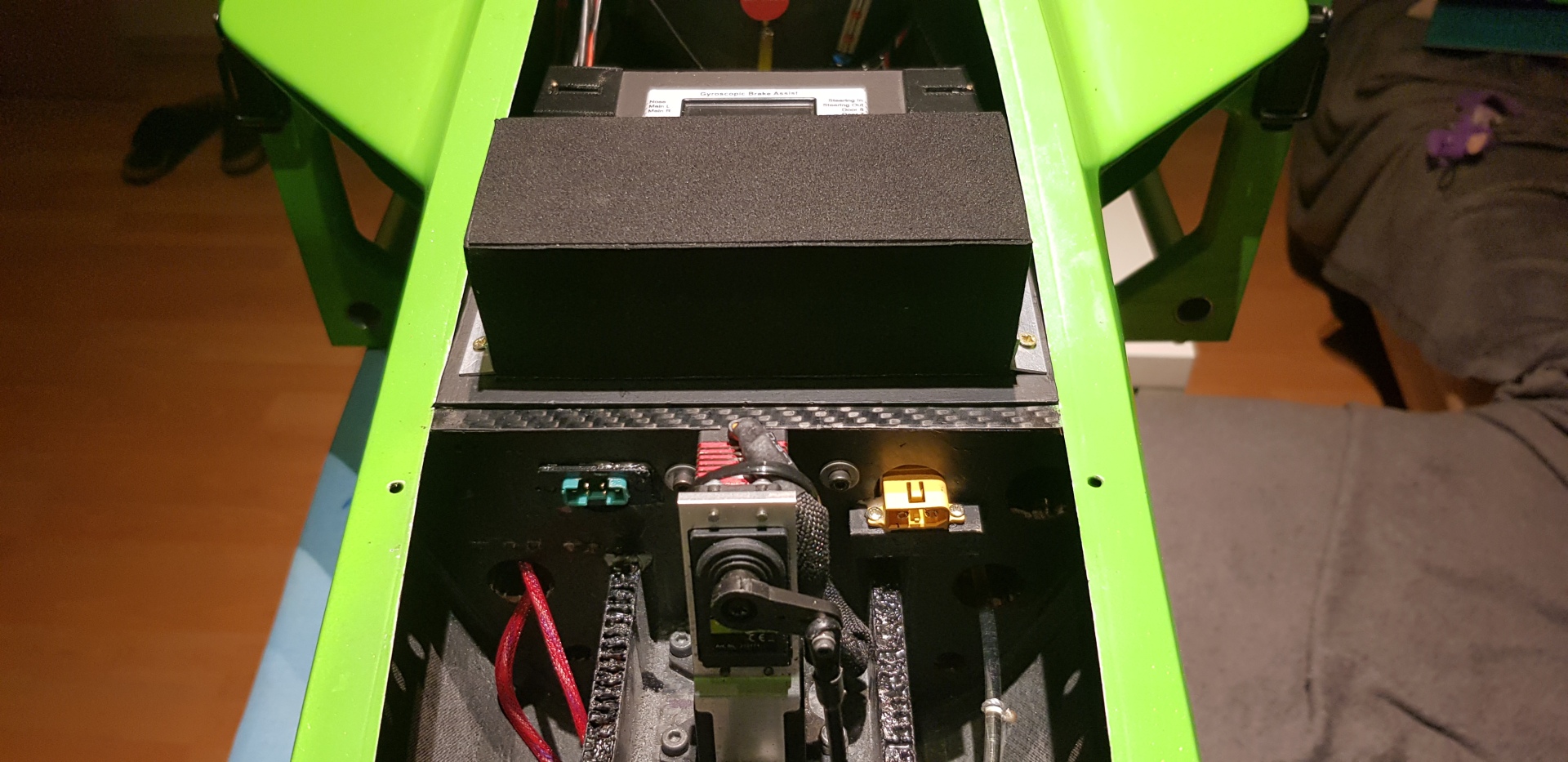

Réponse de Jeti
Dear Olivier,
some types of turbines can interfere with ASSIST receiver sensors (vibration/noise). If such a situation occurs, I recommend three options.
1. Mechanical vibration interference can be transferred to the sensors by cables. Please put the ASSIST Receiver on Double Sided Rubber Adhesive Tape and mechanically grip the input and output cables (photos are in attachment).
2. For high sensitivity or interference the sensors from the turbine, I recommend setting the Low-Pass filter frequency to 15 or 10 Hz (not lower than 10Hz, stabilization would be inefficient). Very low and very high frequencies directly affect the sensors of all stabilizations, so we added the option to set these filters. This filters are described in manual on pg. 41 and 49.
3. Make a "noise reduction box" from 15 mm balsa and 1mm neoprene (photos are in attachment).
Dear Olivier,

Re: RECEPTEUR JETI AVEC GYRO
Bonjour la haute technologie !
Etre obligé de mettre un sarcophage sur le RX pour que ça marche
