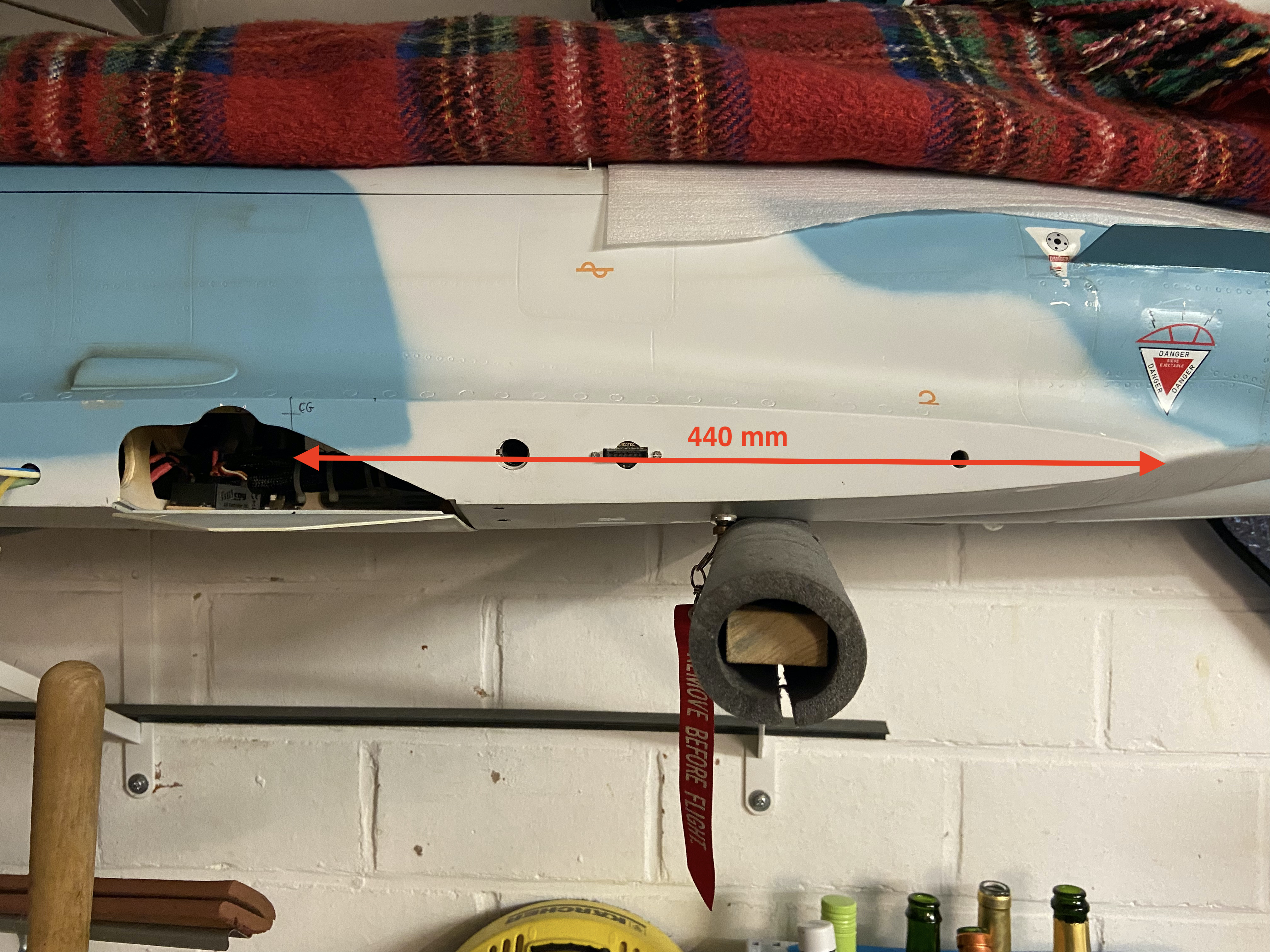

Hello!!!Rafale_Sport a écrit : ↑mer. sept. 02, 2015 9:30 pm poids et CG à vide (UAT pleine, cockpit avec 2 pilotes et batteries en place)
I would like to know which was the place you used as a reference to level the mirage and use the xicoy balance meter.
Thanks a lot!
- Rafale_Sport
- Messages : 390
Re: [Construction] Mirage 2000 Feibao
Hi, not sure about your question, but there are screenshots of the CG meter on page 26, the CG is at 440mm from the leading edge on the fuselage (see picture). Hope that helps.
