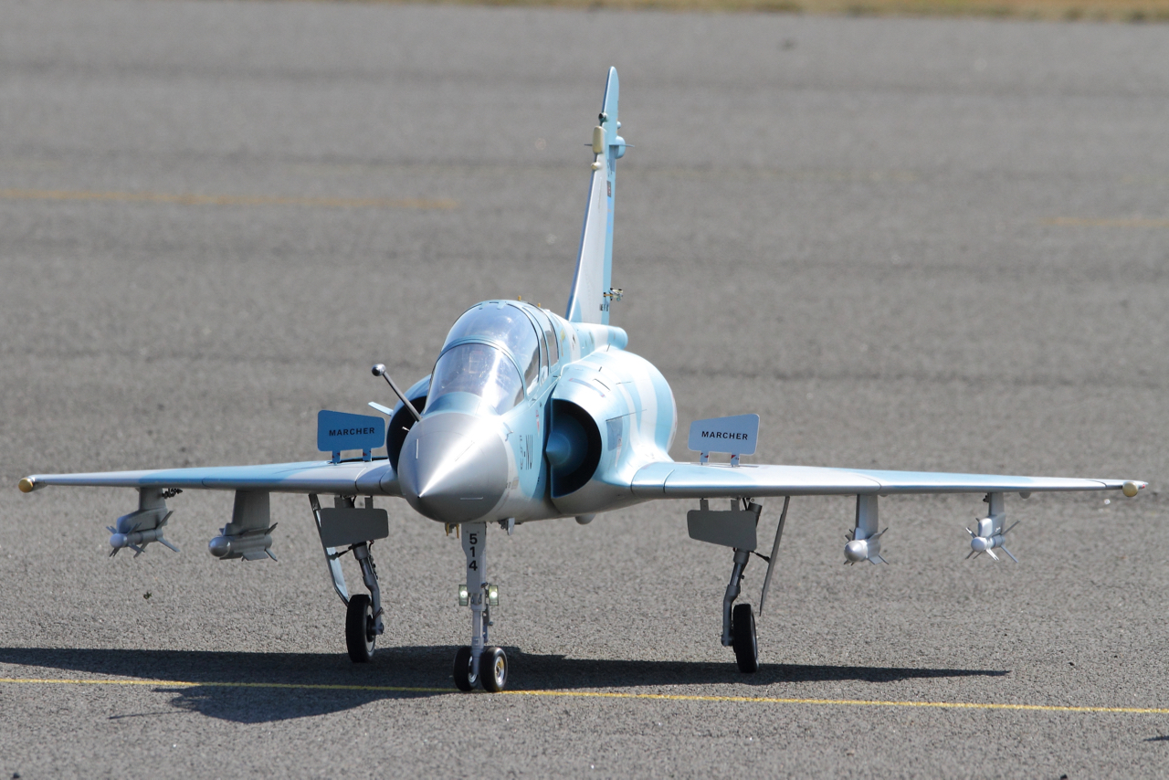

Re: [Construction] Mirage 2000 Feibao
Hi Laurent,can you please help with the air retracts?The main retracts cannot retract on the air even if i push 130psi air!Do you have any tip?Regards Mike!Rafale_Sport a écrit :Saison 2018, toujours beaucoup de plaisir avec ce M2000
- Rafale_Sport
- Messages : 390
Hi Mike, this is indeed a weak point and time to time it does not retract properly as well. My current set-up is made of 2 pressure tanks and Jet-tronics valves working at 9 bars (130PSI). The trick I use to be the most successful is to retract the gear at low speed, thus not right after take off but only after the first turn, I slowed down the speed and then retract the gear. Note that you need to put a longer timer on the main gear door to let enough time for the main gear to retract before the doors close. It works in most cases but depending on the wind/speed condition it may fail time to time...good luck and great filghts.
